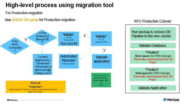

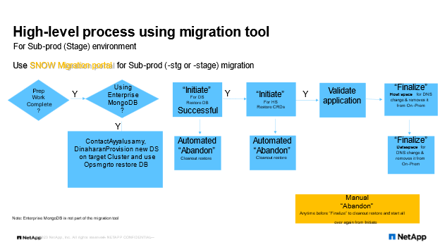

High-level flow of migration

Getting Started with Migration /Disaster Recovery DR
- Migration / Disaster Recovery (DR)
- Recording to demo production / DR migration of Tiny URL Applciation
- Zoom Link
- Passcode: EiBb3#uZ
ServiceNow Sub-Prod Migration Documentation (Migration Portal)
ServiceNow Production Migration/DR Documentation (DR Portal)
