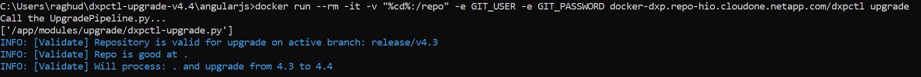

The output of all of these phases look like the following:
Validate Phase Output
scale-pipeline-upgrade-tool
After verifying that the target directory contains a valid SCALE project and is clean of any outstanding updates not committed to Git, the old and new pipeline versions are displayed as well.
In the event that one of the phases encounters an error and cannot continue, the upgrade tool will stop at the point of failure. Depending on the phase, some partial updates may have taken place and will need to be rolled back. In these cases, refer to the Rollback of Updates Prior to Commit section below.

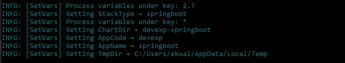

SetVars Phase Output
Every variable assignment is listed and if a variable value cannot be determined, the user is prompted for the value

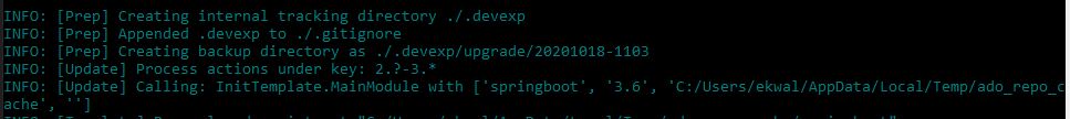

Prep Phase Output
The output from the Prep phase will indicate the path to the backup of the project repository preserved prior to applying any changes. Note that the directory under which this backup is saved is added to the .gitignore file for the project so that the backup will not be preserved as part of any commits to the Git repository.

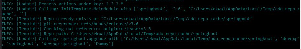

Update and Template Phase Outputs
The Update phase actually includes the Template phase, which is actually the first step carried out, so the output will initially show the start of the Update phase, continue with the Template phase and finish again withe the Update phase.
If the retrieval of the Template files required for upgrade needs authentication from Git, the user will be prompted to complete the authentication.

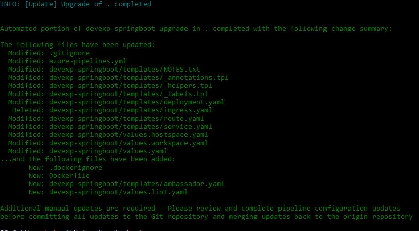

Final Output after the Update Phase
Upon completion, a summary of all project files updated or added (or removed, in some cases) will be displayed. All modified (or added) files should be reviewed, after completion of the upgrade run, before the project repository is committed and pushed back to the Azure DevOps Git repository.
